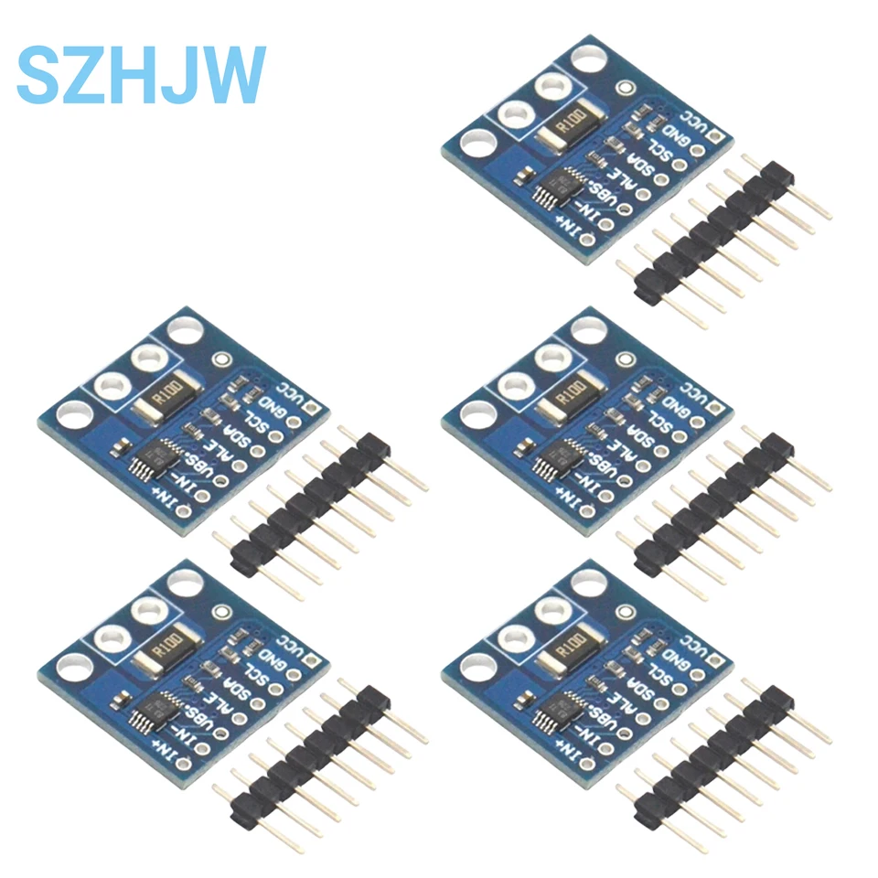

You can use 3 IBT2 driver (BTS7960)
And 3 INA226 sensor , By this way the motor speed PWM is OK and the sense feedback ovber I2C can protect the 3 mow motor on overload.

I don't really understand what you do on the driver command :
If you use ZSX11H motor driver : It's a 3.3V driver and why did you use a relay , simply connect the PWM signal input of the driver to PCB1.3 PWM mow output ?

//on robomow you have 3 mow motor and sense is read over I2C using INA226 module
#define INA226_MOW_SENSE true
//#define INA226_MOW_SENSE false
Change the Amrobotdriver.cpp according the 3 screen copy (Green is add and red is remove)
Adjust according how many motor you want to manage over INA226.
Do not forget to use R010 resistor on INA226 or directly order the correct one.
I hope i forget nothing.

I will order some INA226 and try to get it working.

Would this code still be somewhere available (it seems to have disappeared)? I would like to do something similar to measure battery voltage using the INA226 (on arduino due). If not, I guess I will remake something similar.
thanks
edit: nevermind found it back, will try to get it to work :)
