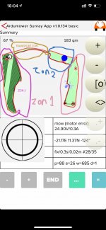

Hi,
I think I was suggested this before but it had been nice if I can split one map in different zones.
For example, I want only to cut my backyard. (Zone 2) Frontyard (Zon 1) Everything: All Zones.
I'm also at moment testing docking but was got a problem. I need to test a little more before I can give suggestions on improvments.
UPDATE: Maby skip 10/25 Waypoint could be a quickfix and skip waypoint button in mapview.
BUG: Also I think there is a bug if you press skip waypint when mowing. You need to stop machine and then press skip waypoint otherwise it may want to fly to next place in no map area :)
